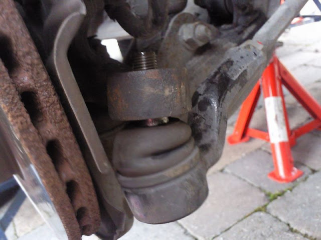

Take out split pin on ball joint, undo nut, turn nut upside down and screw back on till its flat with ball joint shaft top. Hit sharply with BFH, undo and redo nut if it takes more than a couple of hits (to be sure you aren't "mushrooming" the shaft). It should pop with some cursing.

yeah, it was def the left one that was loose.... I could move the ball jointed end about with my little finger whereas I couldn't move the new one very much at all! I guess its because its closer to the side of the road and hits more potholes. Def worth the hour or two it took. Not sure how long they took as the anti-roll bar end/drop links took feckin aaages... what a PITA that lower joint is!
