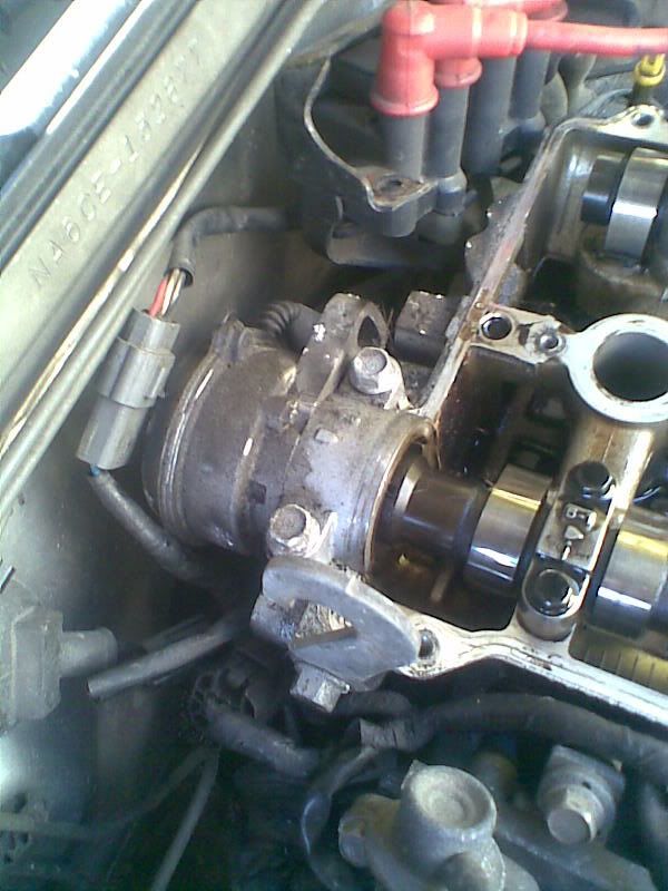

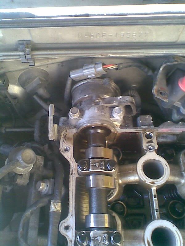

Here's some pics of the CAS that a 'mechanic' fitted last year when he installed this engine.
It appears to be upsidedown....what would this do to the timing ? Double it ??
I've also noticed that the coil pack is sitting about an inch ABOVE the valve cover and not flush on top of it.

The CAS can't be fitted 180degrees out unless its been modified (or possibly from a 1.8?). Has the car been running with it like this?

Heres some good info on fitting the CAS, it can be really frustrating if you don't line up the little arms ("dogs") EXACTLY right.. try peek in to see which is facing which direction :
".. be sure (by eye or feel) of the orientation of the key in the cam, then adjust the CAS to approximately match it before sliding it in place. You then press in and hope; if it doesn't go in, back it off just a hair, twist a little, and press straight in again. Don't turn the CAS while it's in contact with the cam key, or you'll just be rotating the CAS and it will never go in.
Beware that the key is offset on the cam shaft, but only by a tiny amount. It's real easy to think it's 180 degrees away from where it's really sitting. And I've seen the CAS go into place that way -- it's not supposed to, but with a little wear and a heavy hand, it can, and it's the devil to figure out why the car won't run. Be gentle -- when it's aligned right, the biggest resistance is getting the O-ring into the hole.
Speaking of the O-ring, whenever you pull the CAS, put in a new one, oiled. Once the O-ring hardens, it just makes this process harder, as well as setting you up for an oil leak. For less than a buck, just toss it."

Ok that 'mechanic' is a bit of a 'BigFoot' and I'm sure he would have hit it with a hammer just to get it to fit.
I can try refitting the CAS but if the car has been running like this for about a year now, would the piston rings be fried by now and hense the black smoke out the air filter ?
