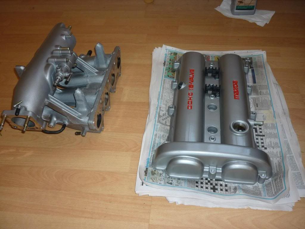

Sprayed up my inlet manifold, air valve to match my rocker cover :
in the car :
Installed an inlet manifold thermal insulating gasket when I was putting the manifold back on, supposed to limit heat transfer from the head to the mainfold
Did the timing belt aswell, used a cam locking tool I got from Flyin Miata and a crank locking tool from Rennenmetal, made the job very striaghtforward for a novice diy mechanic!

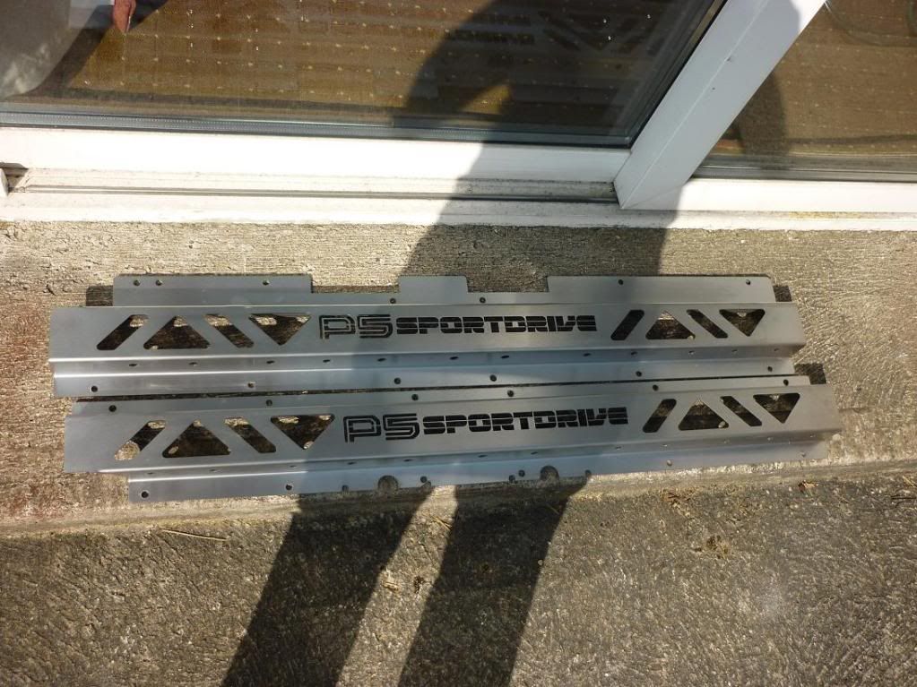

Finally got around to fitting my chassis rails today, cant wait to get the car back on the road now to see what kind of difference they make

What did you do with the fuel line?
I still need to sort that, was thinking of useing the original brackets and some self tappers into the rails?

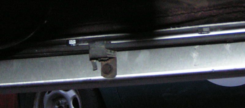

Postby Steve » Mon, 26 Mar 2012 11:45 +0000
thats exactly how I did it, just had to bend the bracket out a little bit :
Postby Piers14 » Tue, 27 Mar 2012 8:09 +0000
The stainless steel is quite tough and it may be difficult to get a self tapping screw to work well. It may be easier to drill and tap the hole.
Thanks again for sorting this great purchase Steve. BTW, I bonded them in place with Tiger Seal which I'm hoping will add extra strength..

Postby sidewaysreilly » Thu, 29 Mar 2012 2:58 +0000
luxury of having a MIG Welder. Roughly marked the rails in line with the origional bracket mounts. Drilled a clearance hole and tack welded a captive nut behind the rail. All mounted as origionally intended.
