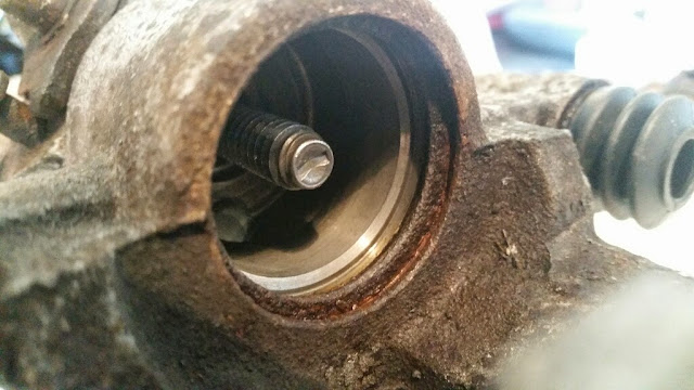

took off my sticking rear caliper earlier and took it apart.
It was pretty mucky in there, the piston was pitted with rust and a couple of the dust covers were torn.
Before :
It cleaned up ok with a bit of elbow grease :
Old Piston vs New Piston :
Replaced all the seals + rubber bits, the new piston went in ok too.
Decided to crack open the bleed nipple before I put it back on the car (and check it was all clean in there)... and it snapped in half.. GAH!
Oh... and discovered I've a broken rear spring ... great

Postby Steve » Mon, 30 Mar 2015 12:04 +0000
Had a hack at the bleed nipple yesterday with John M. Heat wouldn't move it, ez-out wouldn't move it, drilled it :
Still couldn't get it out, kept increasing drill bit size until we got to the stage where the threads were starting to appear.
Its like the threads are welded in there, none would pick out or collapse at this stage either.
Its going to a professional now :-(
