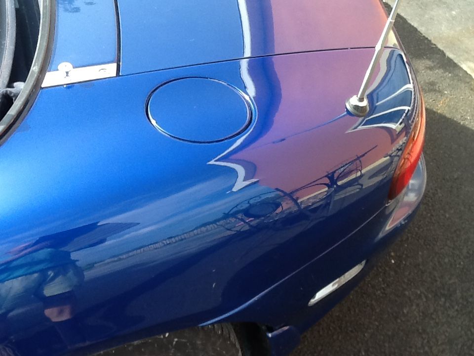

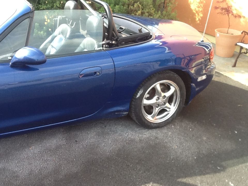

Re: What did you do to your MX5 today ?Repainted my rough quarter panel today using aerosol cans , for a diy job I think they work purity good
![]() ![]() Next is wash and polish ! Brian ]96 na Merlot edition. sold

Re: What did you do to your MX5 today ?That looks shit hot Brian... well done.. can't believe you got that finish with cans.. 2002 MK2.5 Sunlight Silver (sold)

Re: What did you do to your MX5 today ?Actually looking at the picture again... what happened to your sill.

Re: What did you do to your MX5 today ?Jeez Brian, that,s brillo job for rattle cans.Never seen them work out so well.I think the quality of the mixed aerosols are much better than off the shelf ones.Vinny Byrne paint suppliers does some here in Dublin and they are excellent also apparently

Re: What did you do to your MX5 today ?wow Brian, great job! Where did you get the cans mixed? I've a back bumper on a non-mx5 that needs to be done
Re: What did you do to your MX5 today ?Thanks for that gents .
The method is quite simple .......preparation First sand down the panel really well to get rid of all marks / scratches , any dings tapped out and filled . This could take a few passes . I them primed the entire panel with a number of coats, light and often is the way to go . Wet sand this with 800 wet and dry . Wash down entire panel . Colour is next and the same really light coats and a good few passes until you are happy with the coverage , for me one can Just did the quarter , for larger panels I suggest you will need more or a spray gun . For me no sanding here as I didn't have anymore paint ! Let it dry then spray on the clear . I used u pol brand as it came with a better nosal for better coverage , again thin coats and many letting it dry between each coat , here I used 1.5 cans ! So takes a bit of time . Leave it for a couple of hours , I had the car inside on a hot day with a heater under it . After this is dry you start to flat it using 2000 , 2500 and 3000 wet and dry , doing this correctly is the secret .you really need to get it all down flat with no dimples at all in the finish . Once it all flatted it will look horrible with no shine at all , this is good as it's all at the same level , to bring the shine you are now compounding it . I used menenzerna power finish but any compound will work , I also used a DA polishing machine but by hand will also work . Allow a day start to finish and work indoors Ray that damage happened on a very wet Galway run trying to stay with Steve , he is on rain sports I'm on ditch finders , stone sticking out on the road side .............I think you can guess the rest That's a good contact Robert re the paint , I got paint locally before but the colour match was really bad Brian ]96 na Merlot edition. sold
