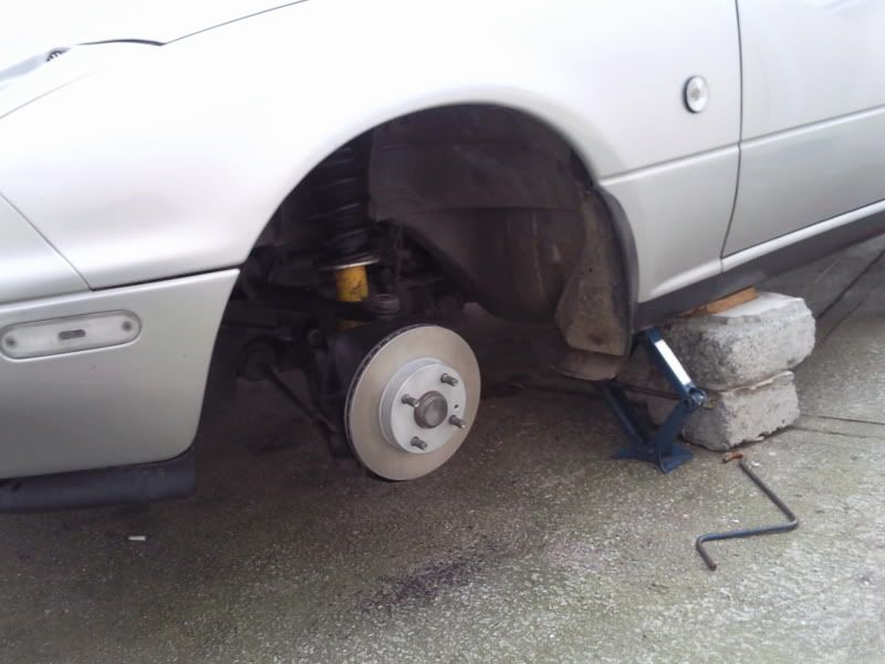

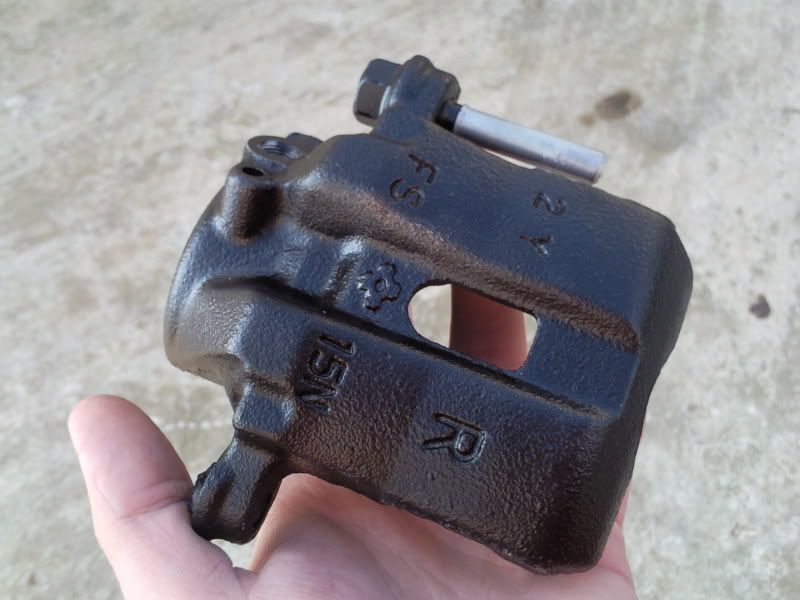

Started off with me going out last Sunday morning to give the callipers a quick lick of paint, Then decided that i would take them and the brackets off and get them shot blasted before painting them (thanks Dave), Whilst they were off I thought may aswell get new seals and strip and rebuild them, I also got new discs from mx5parts when they were on special offer so had these to fit, But thought it would be a shame for them to rust on the none contact areas as they all do so i gave these a coat of zinc paint (hope it can stick the heat).
Callipers have been given a couple of coats of black high temp paint and are now fully back together and mounted on the car.
Just have to refill and bleed the whole system tomorrow and see if its all ok.

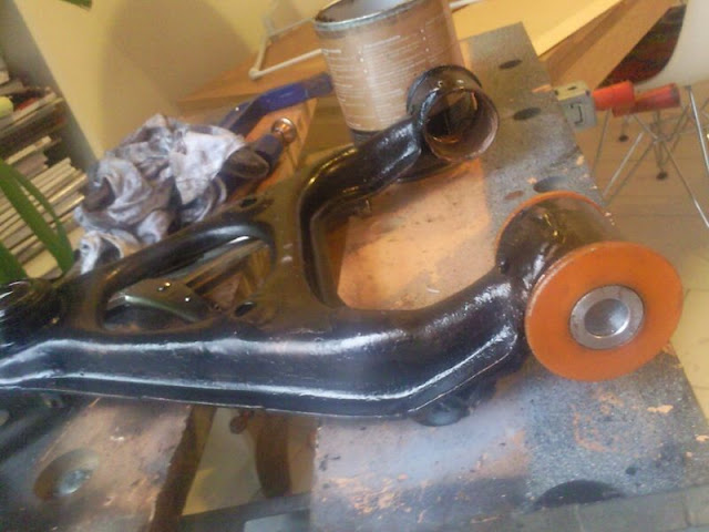

Postby Steve » Wed, 15 Apr 2009 10:18 +0000

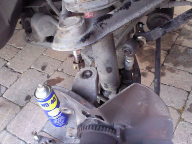

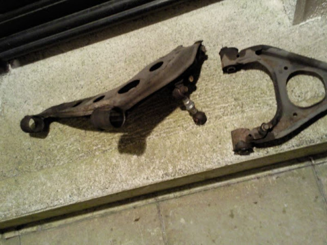

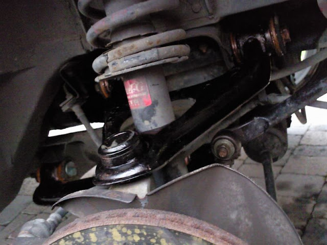

Front end refurb continues.. bought poly bushings for the front control arms.

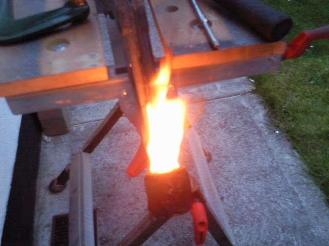

Time consuming job.. involving ball joint popping :
& burning bush(ings) :
2 done :
its v.time consuming/messy/smelly burning them out, use the threaded bar method if you ever have to do it!
It was a real struggle to get the first bush in ... ended up putting it in boiling water for 10 mins and it softened up enough to go in (it was still difficult enough..)
Driver's side back together :
Took the passenger side control arms off afterwards, think I'm going to chicken out and see if a local garage will press out the old/in the new bushs for me... ;-)

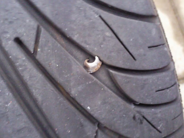

Also found the reason for the slow leak I've had..
Postby ger » Thu, 16 Apr 2009 12:28 +0000
large socket (36 I think) and a threaded bar that will fit through the bush a couple of nuts and washers. Homemade bush puller/pusher. Cost 25 euro or so.
Makes the job of getting the bushes out and in a doddle. Well worth the money.

Garage didn't have time to do it today so he gave me a loan of his ball joint seperator kit .. hopefully it'll pop em out easily..

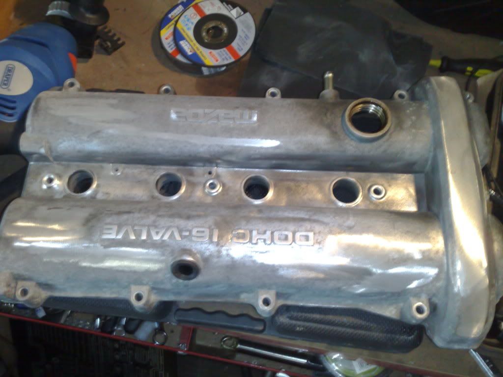

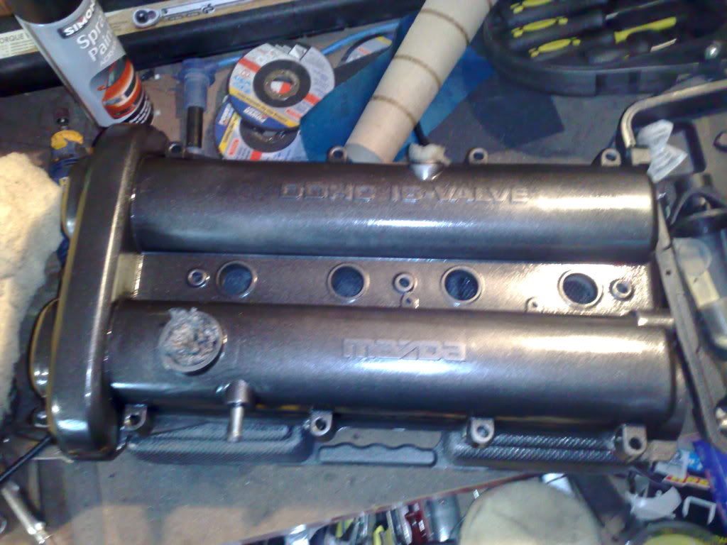

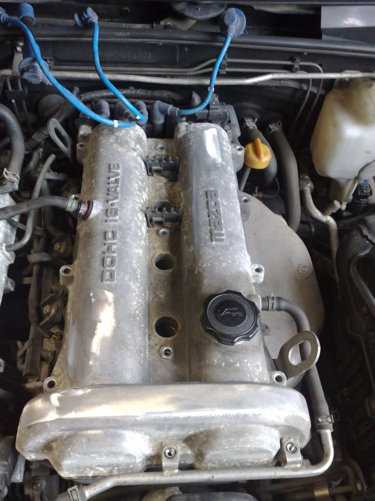

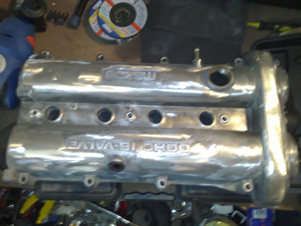

This evening I took off my camcover.
Rubbed/cleaned it down............
getting there......
and gave it a coat or 2 (so far) of lovely Halfords Hi Temp Met Black :D
Together with this new purchase winging it way to me.....Image
................my bay should be a nicer place to behold
:lol: :lol:
Postby fabfiveferg » Fri, 17 Apr 2009 12:22 +0000

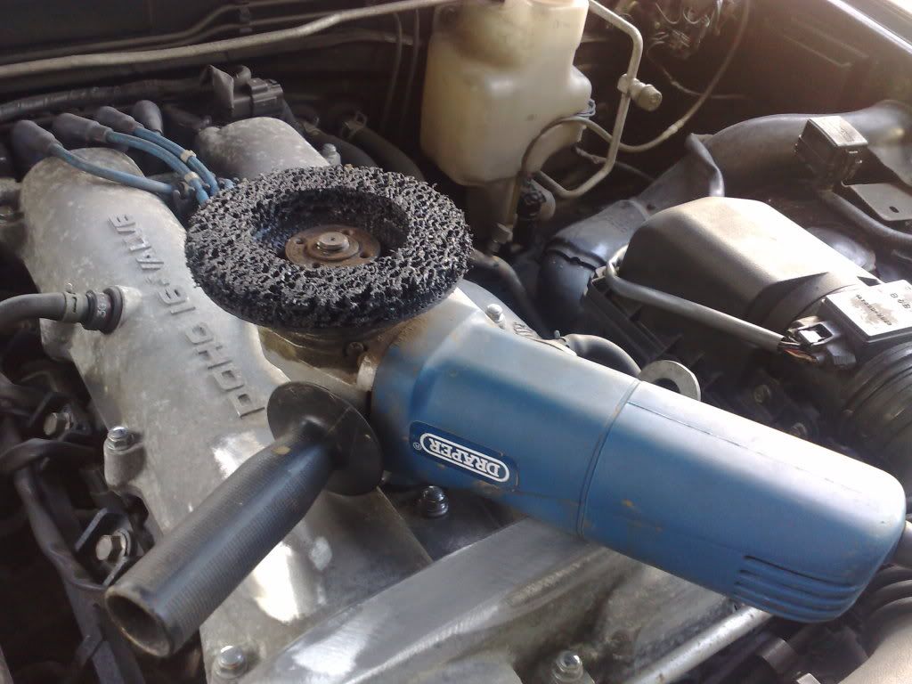

Good man Ollie. What did you use to clean it?
Postby Stig » Fri, 17 Apr 2009 11:33 +0000
Thanks Freg, used this ........Image
and some wet and dry paper, and a Dremel in around those ackward spots. All good fun!

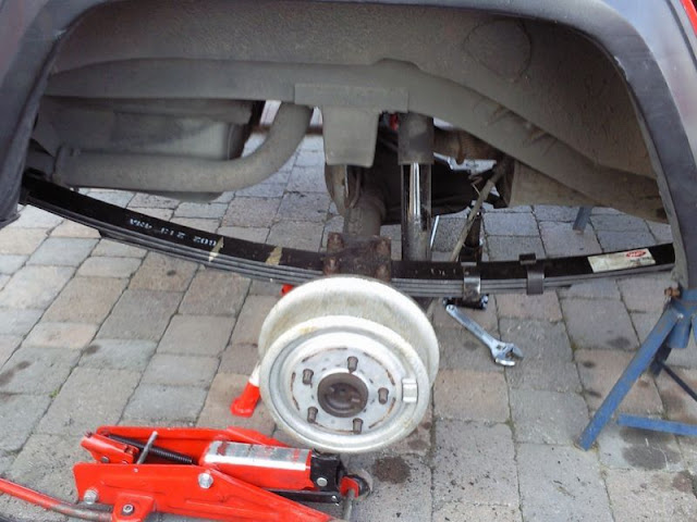

Postby Steve » Sat, 18 Apr 2009 8:05 +0000
Finished installing the bushings, feels FAB so far but still needs an alignment,

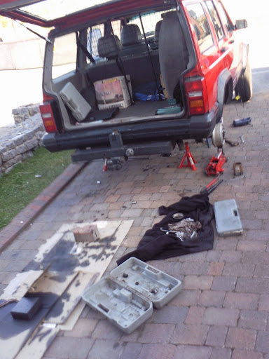

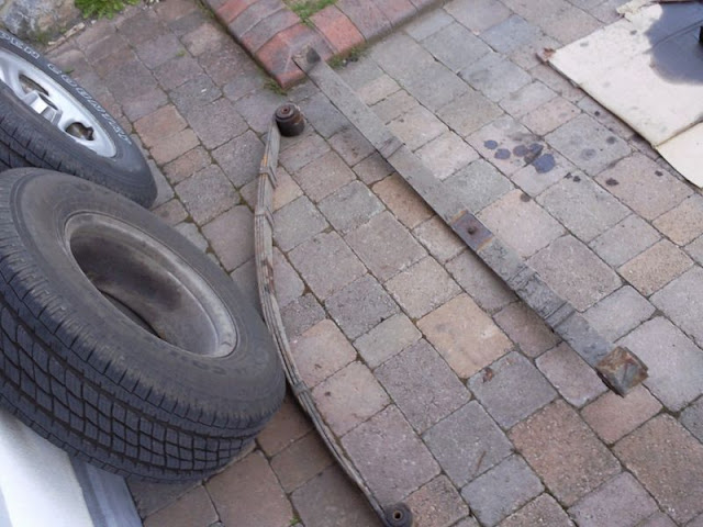

then tore into the Heep today and replaced the leaf springs :
