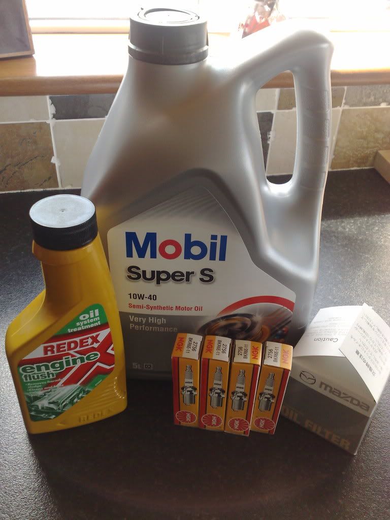

Postby Stig » Wed, 17 Jun 2009 9:04 +0000
This evening I treated the car to;
An engine flush
Oil and Filter service.
New Plugs.
I also fitted new lock nuts to secure my rota cup alloys.
I also took my centre console apart to address a "whizzing" noise from my stereo when listening to the radio. Thought it might be the FM expenader that was hardwired into the car whn it had the jap import headunit, so I took it out and rewired the unit, and the "whizzing" is still there - FECKING ANNOYING!
It's like the alternator causing the "whizzing" on revving the car - any ideas?
Still, overall a good evenings work on the 5 - ready for the IOM trip! 8)
