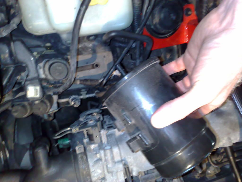

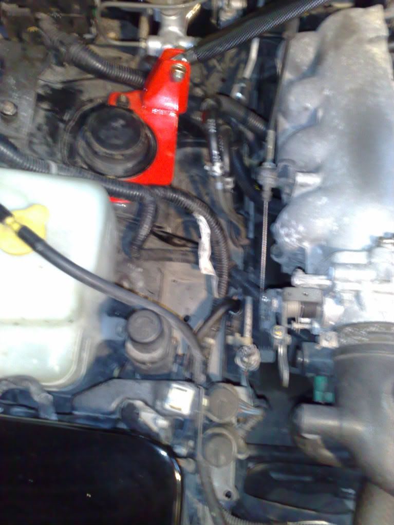

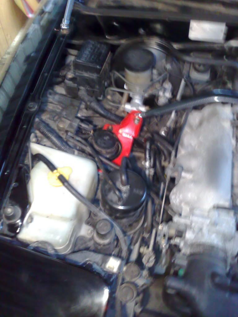

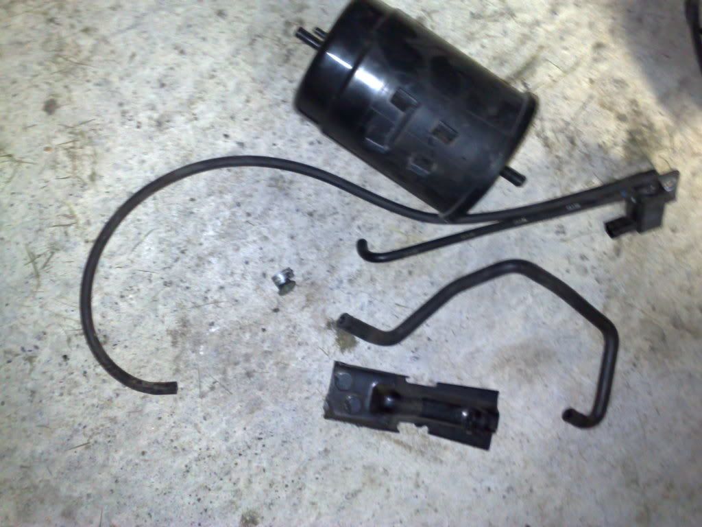

Postby Stig » Wed, 01 Jul 2009 10:34 +0000
Removed the Charcoal Canister from the Bay....
Before -
During -
After -
The removed Gubinzes -
Postby mx5ash » Wed, 01 Jul 2009 11:23 +0000
Nice work, bay needs cleaning though. :P

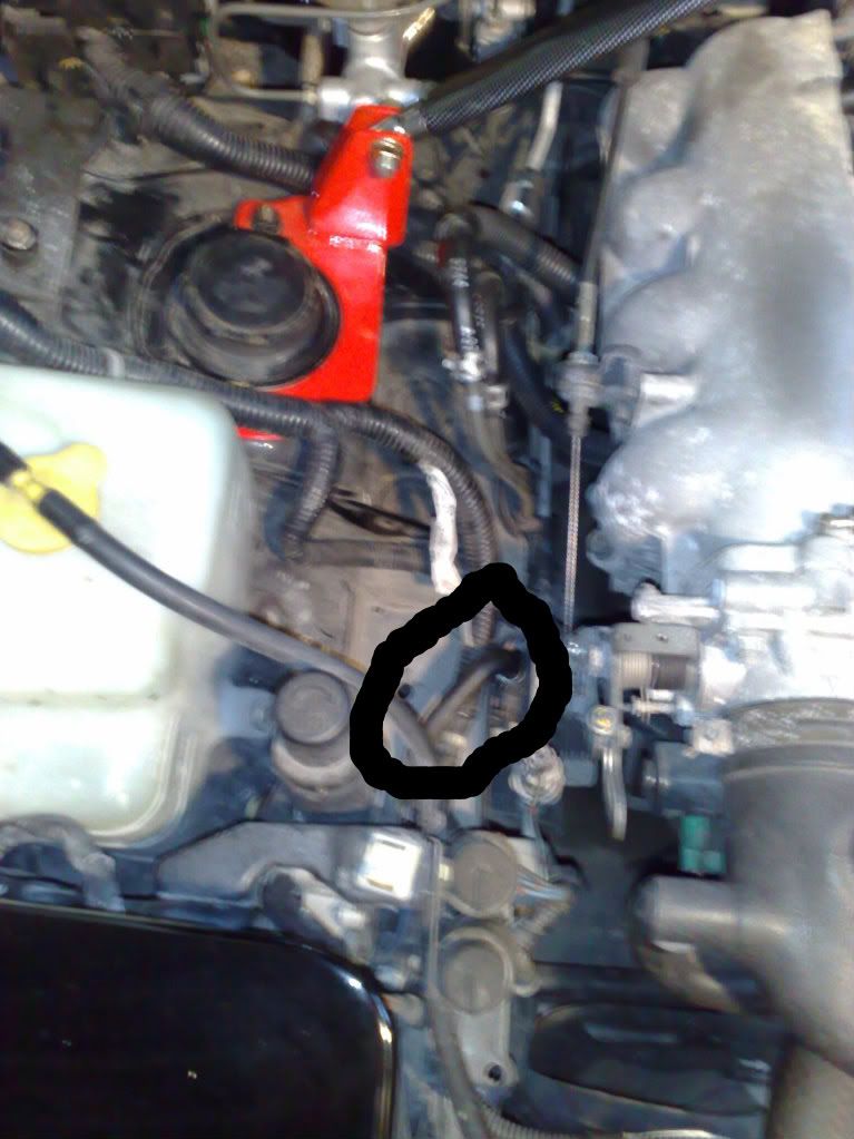

K10 wrote:
DaStig wrote:[color=#0000FF]Removed the Charcoal Canister from the Bay....
Where do you route the old lines to?
Re-connected them circled in this pic (bit blurry, sorry).
Then,blanked of the inlet on the trottle manifold with a little blanker found in my toolbox like so :wink:
I did it to eradicate an annoying "clickey"noice the emmsions valve was making,not really for any other reason"
