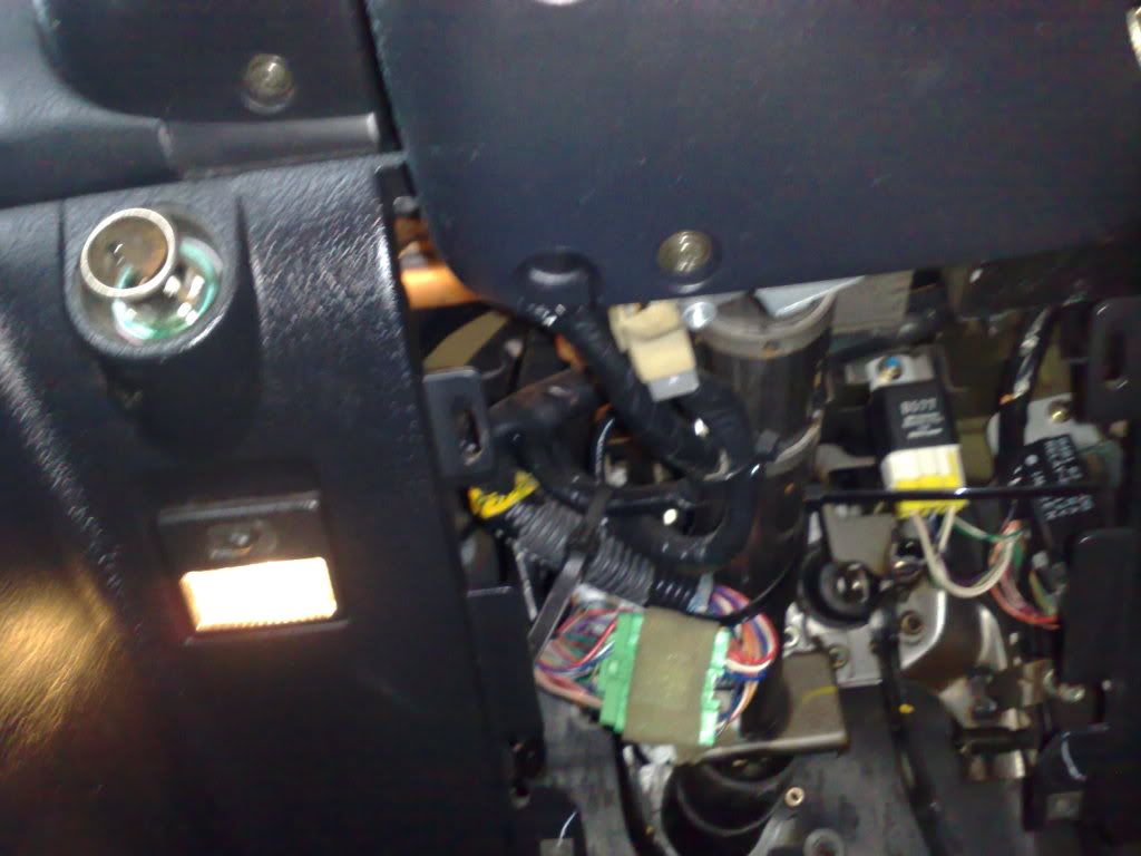

Hardwired in a power cable for my Garmin GPS today - nice neat jobbie, no trailing cables now cluttering up the dash! :wink:

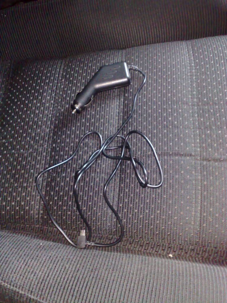

So, this is the power cable bought from ebay for €2.05 :alien:

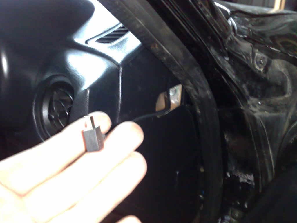

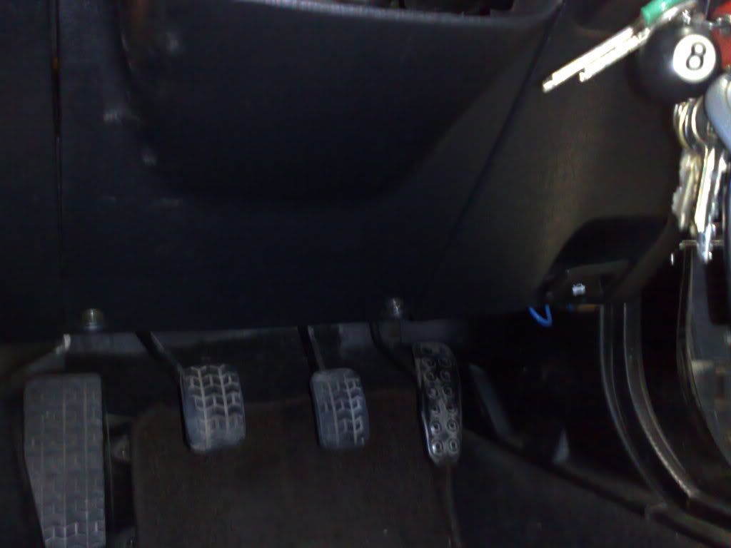

Removed the panel under the steering colum, and poped put the ciggie lighter.
totally pulled out with the help of a long nose pliers....

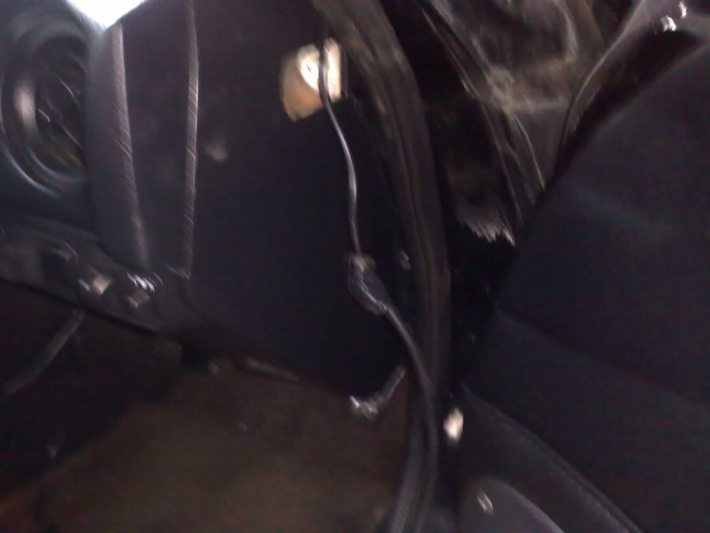

I wanted to set the power cable up into the drivers side corner of the windscreen for a neat install, so I popped the cover on the side of the dash @ the drivers door, the feed an old power flex in to aid threading the new power cable out - not much access in there I can tell you :|
Got it thru'

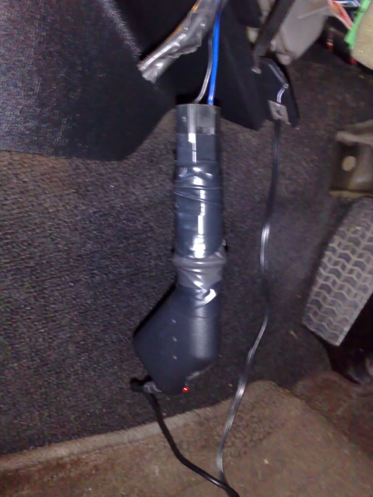

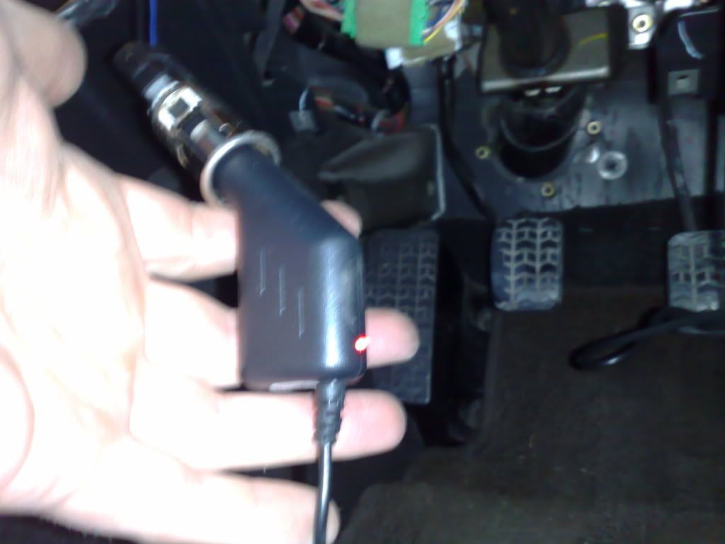

Plugged in the unit to the ciggie lighter socket...but I could'nt directly wire the sat nav to 12V source, its got to be 5V or I'd have blown my GPS to bitz hence the need to plug in the unit.
Taped it up to isolate it and then cable tied it up away in behind the dash -

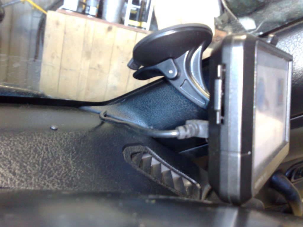

All in place, nice and neat.........
All back together, now just waiting for my starter button that I ordered off ebay to take pride and place in the ciggie lighter hole.

Nice job Ollie, just be aware that the adaptor more than likely has a built-in fuse, so if that blows you're gonna have to take it all out again..hopefully it wont blow too soon. If you could fit an on/off switch on the cable going to the cig lighter it might help the fuse last a bit longer!!!
Postby Stig » Mon, 21 Sep 2009 7:11 +0000
leamyj wrote:Nice job Ollie, just be aware that the adaptor more than likely has a built-in fuse, so if that blows you're gonna have to take it all out again..hopefully it wont blow too soon. If you could fit an on/off switch on the cable going to the cig lighter it might help the fuse last a bit longer!!!
true, but its very accessable in a matter of minzzzzzzzzzzzzzzz

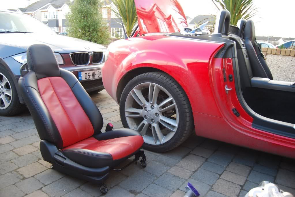

I decided to clean my seats and what was under them, so out came my socket set and a bottle of leather care product and the vacume cleaner! Results were quite good! 8)
