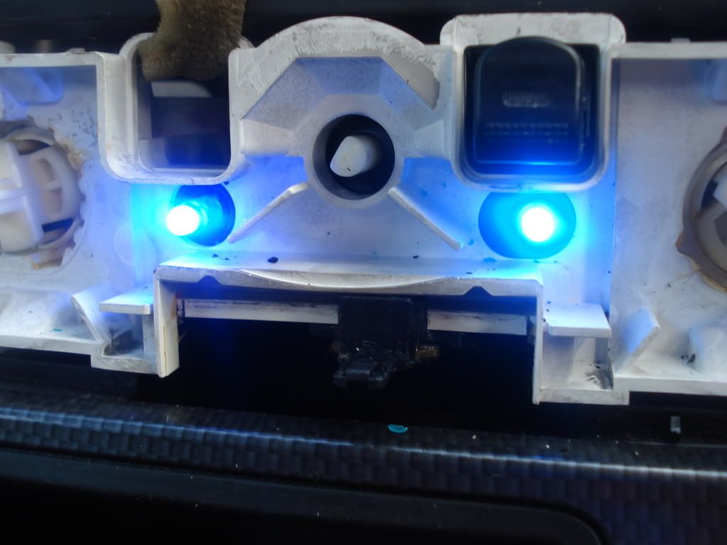

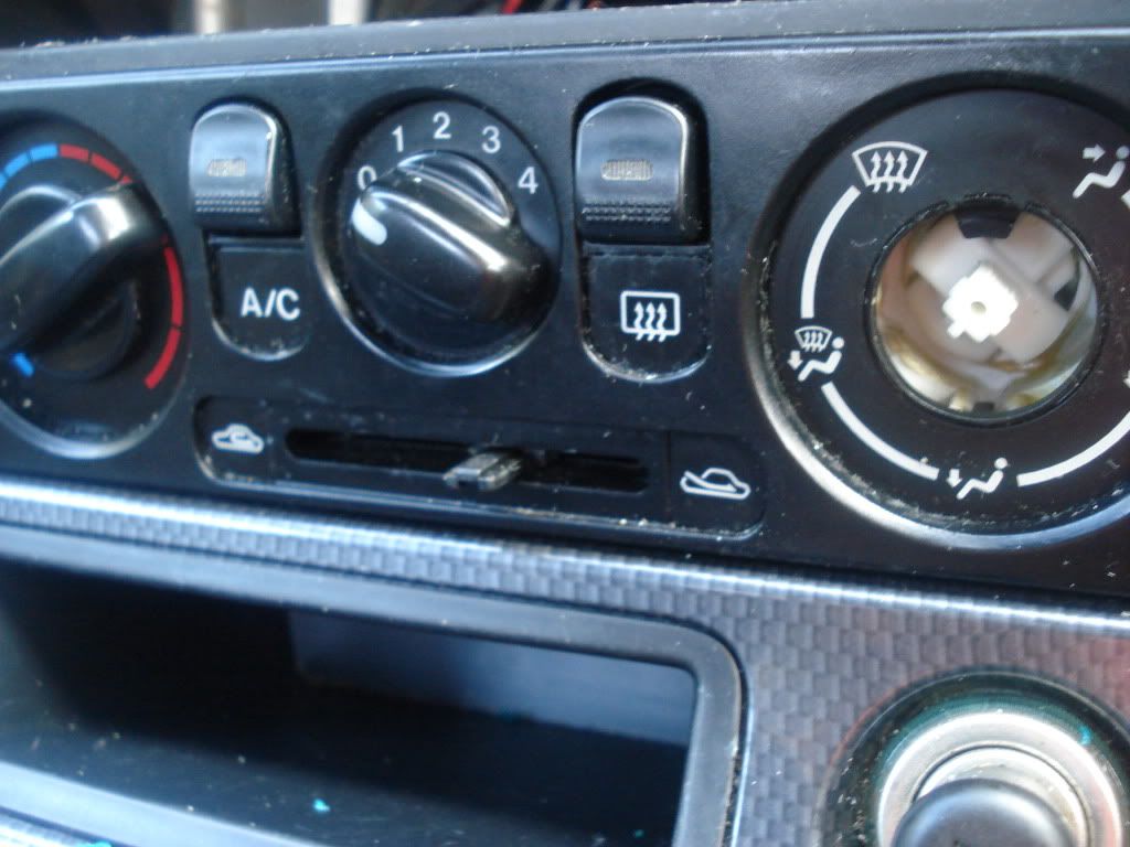

Ok - following the changing of the bulbs behind the dash last week, I tackled the remaining two bulbs behind the heater, yesterday. I have a MkII, so not sure if this goes for a MkI also. The two bulbs are located behind the front cover of the heater control panel. First thing to do is to remove the 3 knobs and the little cover over your slider control. I did this with a small flat headed screwdriver - they were a bit tight.......

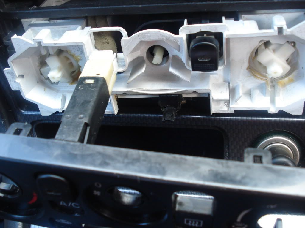

Next thing to do is to remove the two vertical side covers- sorry no photo - again these can be prised off with a small flathead. Now you should see two holes on each side, akin to those found on most stereos. You need a two pronged tool to insert in both holes at the same time - I used a coat hanger cut and bent into a U shape for the purpose X 2. Insert your tool :D on both sides at the same time - this should free the holding springs and you should be able to pull the heater unit a little bit forward. ( I also removed the stereo above to allow me to push the unit from behind) The heater will only come out a few cms as its held at the back by some cables which are connected to the heater knobs. Once the heater has come out a couple of cms you will see that there are 2 N shaped plastic clips on the top - shown below

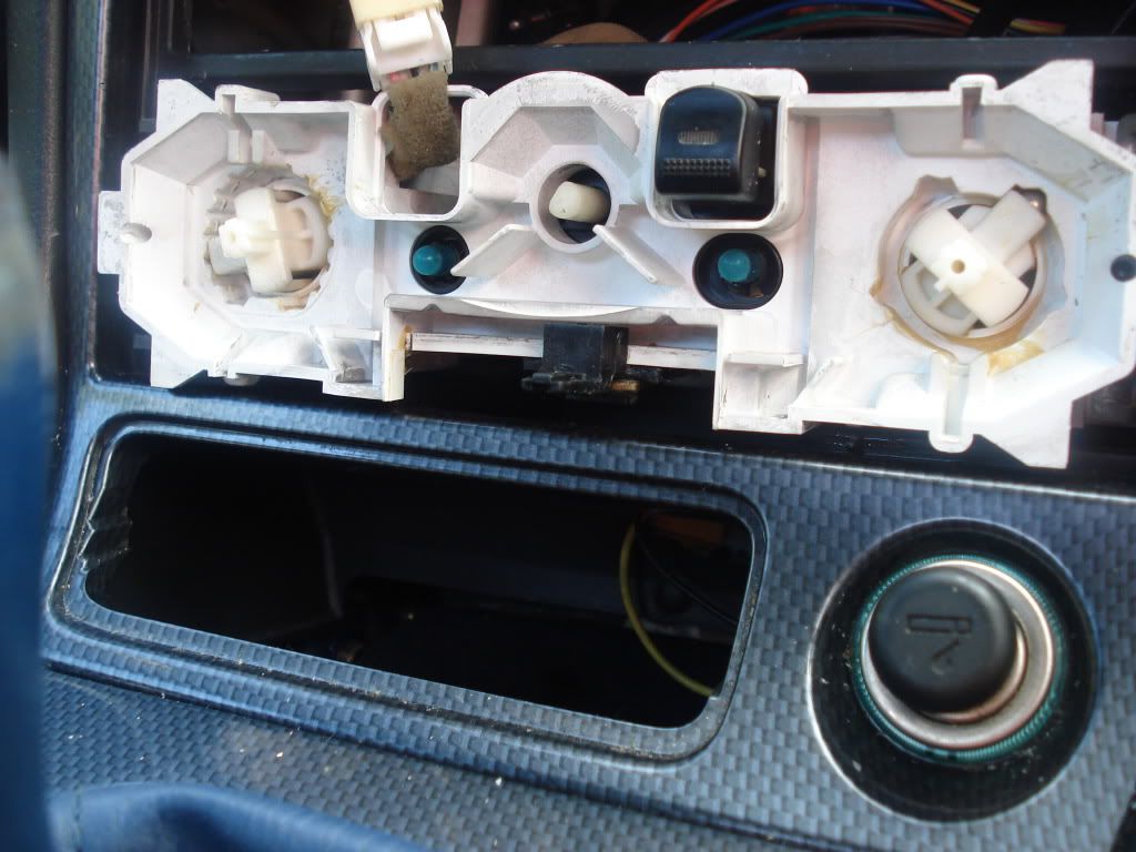

There are two further clips under the unit, which you won't be able to see - I broke one so be careful - but once you prise them all off you can clearly see the two relevant bulbs
The next job is to remove both bulbs. Mine were very tight and it took a good jiggling back and forward with my daughters tweezers to free them from their respective holders. My bulbs had a green rubber type cover over them which came off whilst tryingt to remove them (sorry Bren). I replaced my bulbs with blue LED's - I believe that these only work one way - the attached photo showss which way I put them in
they just push in - be sure to turn on your lights at this stag to be sure they work

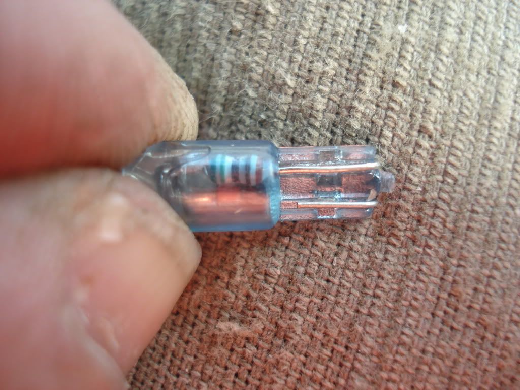

Now its just a matter of putting it all back together which is the reverse of the above. Now tall the internal lights in the car are blue - personal choice but I like it - goes with the interior of my 10AE. Bren attached is the photo of the bulbs I think your looking for
Image-as you can see two of them have lost their green colour - but your welcome to them all the same - hoping to be at a techday next week !!

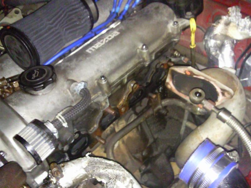

Took off turbo + manifold this eve, then test fit the new one :
Oil change + Mazdaspeed engine mounts tomorrow while I have the space.

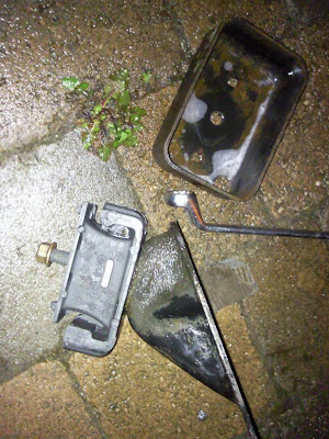

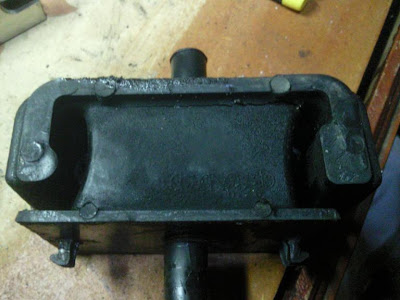

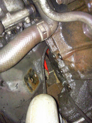

Postby Steve » Wed, 24 Mar 2010 2:04 +0000
Changed out the engine mounts. It was a PITA, especially the driver's side one, the steering gets in the way, hope it'll be worth it.
Haven't had a good look at the old ones yet, but passenger one was obviously torn/split.
Engine mount bolts out :
Mount removed :
disassemble and swop out old mount :
mount split/torn :

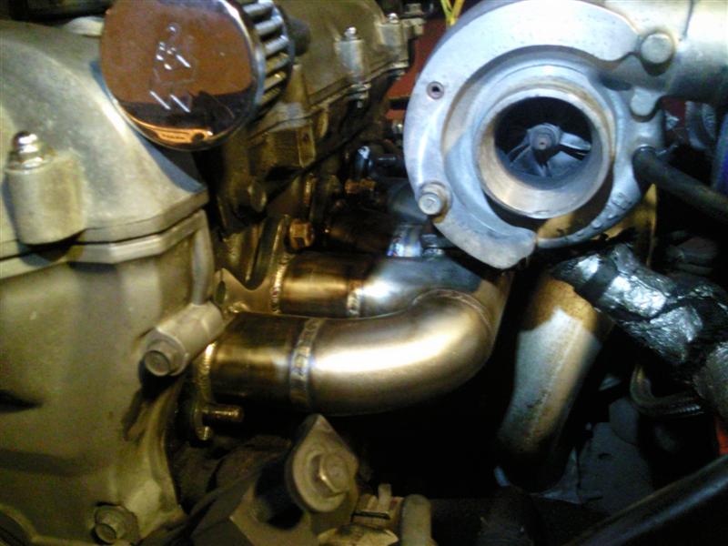

Postby Steve » Mon, 29 Mar 2010 10:09 +0000
Steve wrote:Changed out the engine mounts. It was a PITA, especially the driver's side one, the steering gets in the way, hope it'll be worth it.
Yup, worth it :-) The old ones were obviously toast.
Manifold in, wasn't brave enough to test it in the wet.
