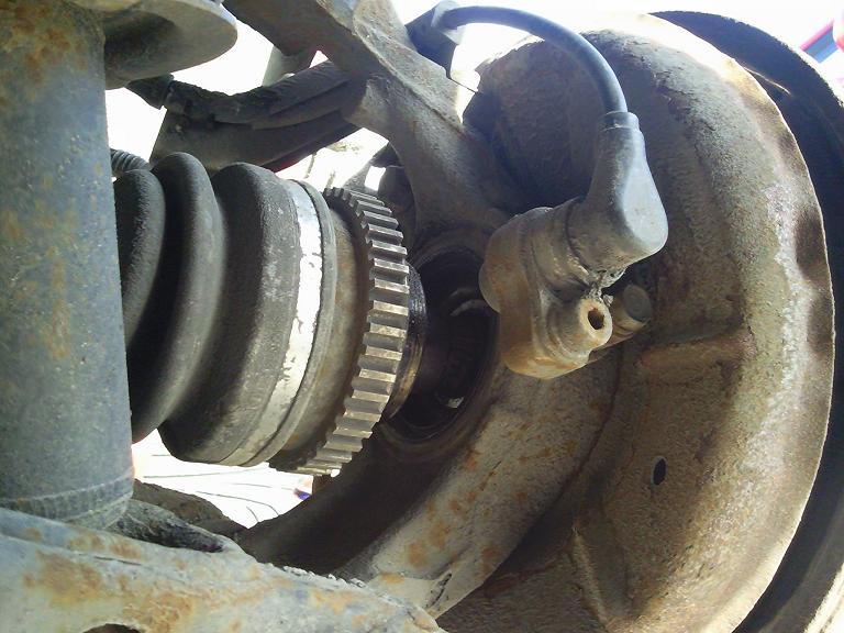

Installed a Limited Slip Diff with big help from Mike and Kieran yesterday.
You should see some of the stuff he has hidden away ;-)
Pulled his drift MX5 out and dropped out the diff in a few hours.
Then set about dropping out the open diff in mine and discovered issues.. mine are ABS axles .. and the ones from the drift car weren't ABS.. to transfer the toothed ring we'd need a press. We didn't have a press.

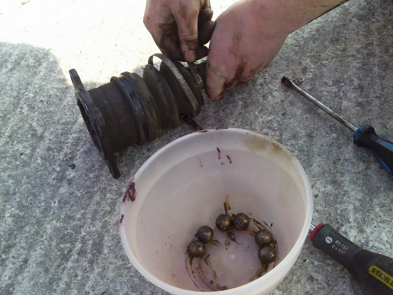

So.. we went with kieran's idea and converted the ABS axles to stub axles instead.
They fell apart on us a few times but we eventually got them together.
So, out with the old diff, then in with the new.. except.. we had to remove the exhaust, braces.. etc, then couldn't align the diff on the PPF, then couldn't find one of the collars that fit in the PPF for the bolts.. we nearly gave up at this stage as it was 9pm.. and we only had one head lamp to work with.. eventually we found the collar and fairly flukely got it to line up (pheeeww!).
Eventually got it together and finished up at 11.. home at 1:10am.. I really really hope I don't ever have to do this job again.
