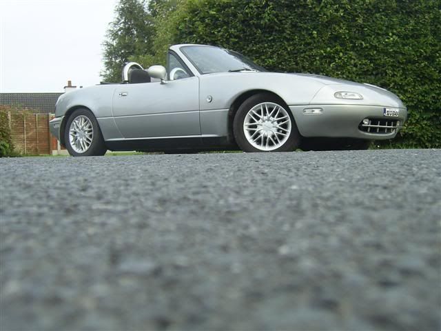

Postby mx5ash » Thu, 01 May 2008 10:31 +0000
Got em from Phil at p5 but he is no longer selling em. You could try the fm site, got a qoute for shipping not long ago from them direct and if you don't get hit for tax then it worked out cheap (ish)
Not got them fitted yet but hopefully by the ned of next week i will have me on.
This is how it sits at the moment (well its got different wheels on now)
