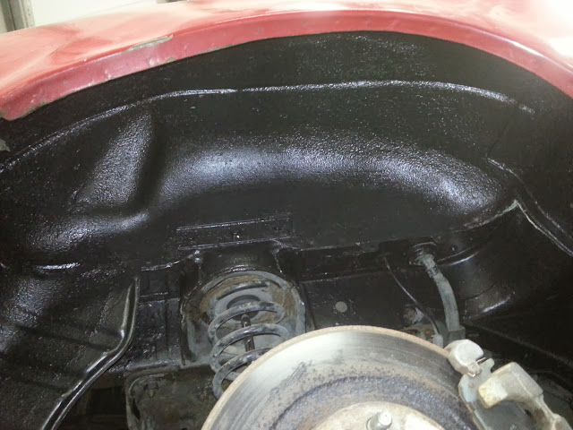

Bit more progress on the undersealing over the weekend.
Started peeling/scraping back the existing underseal in all the spots where it was slightly raised and found surface rust under it. Wire brushed/scraped it back, treated with ferrozine, let dry over night and undersealed. Small bit at the back to finish, then the main floor bit needs to be done, which should be much easier as its flat.
The boot floor photo makes it look worse that it actually was, its a HDR photo, it was surface rust only.
Before, during and after :
