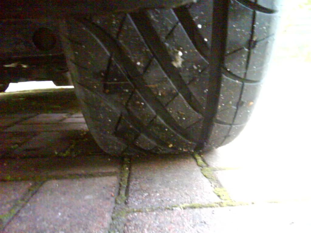

Postby Geese » Tue, 19 May 2009 8:44 +0000
Got the alignment changed on the car today by the lads in Rathcoole. Since I mainly do motorway miles now.
old settings
Front, Caster max, camber -2.25deg toe 1.5deg out overall
Rear Camber -4deg 1deg toe in overall
New settings
Front Cater 4deg camber -1.5deg toe 0
Rear Camber -2deg 0toe
Also got new shoes
