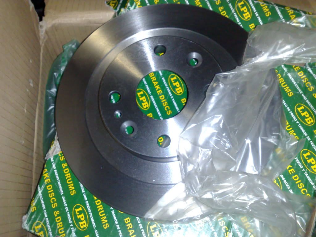

These arrived by courier today, got them from buypartsby before the uk VAT increase.........I look forward to getting them on. :wink:

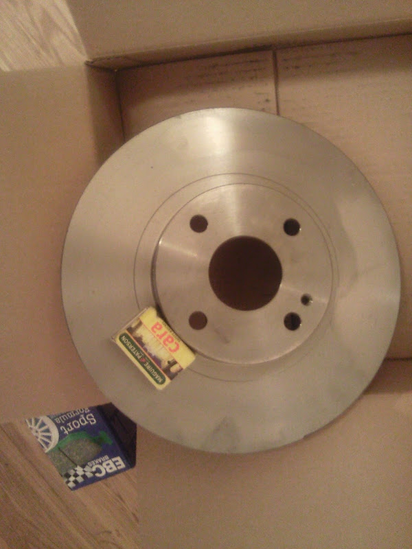

mx5parts, my front disks needed renewing.. was just going to renew them and replace the rear passenger side piston seal.
Then saw a set of mk2.5 Sport brakes for sale.. they just needed rear pads and front disks. Will have to wait for the weather to warm up a bit before I install tho'.

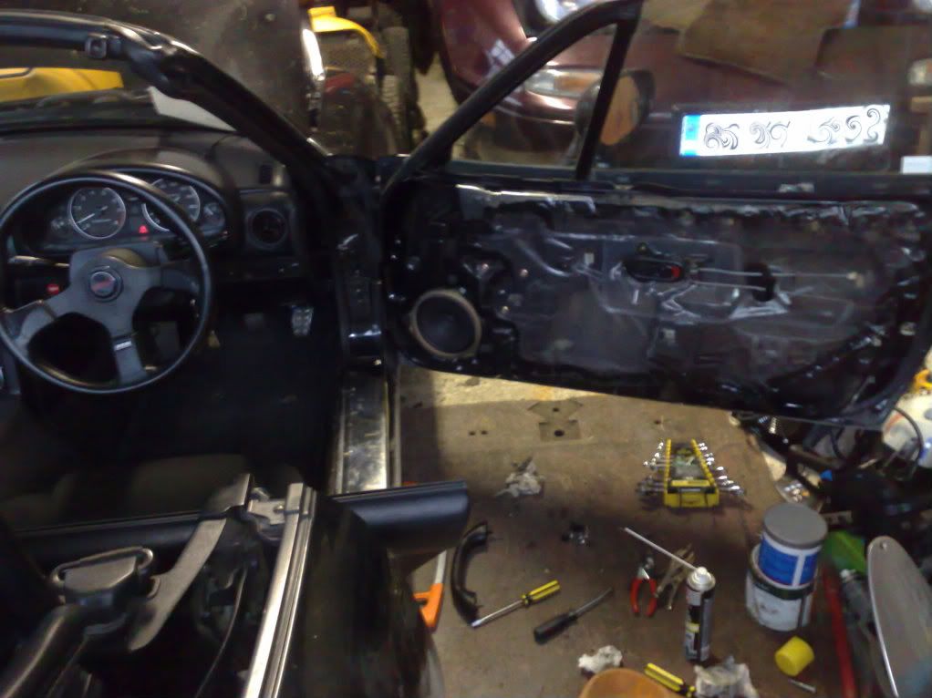

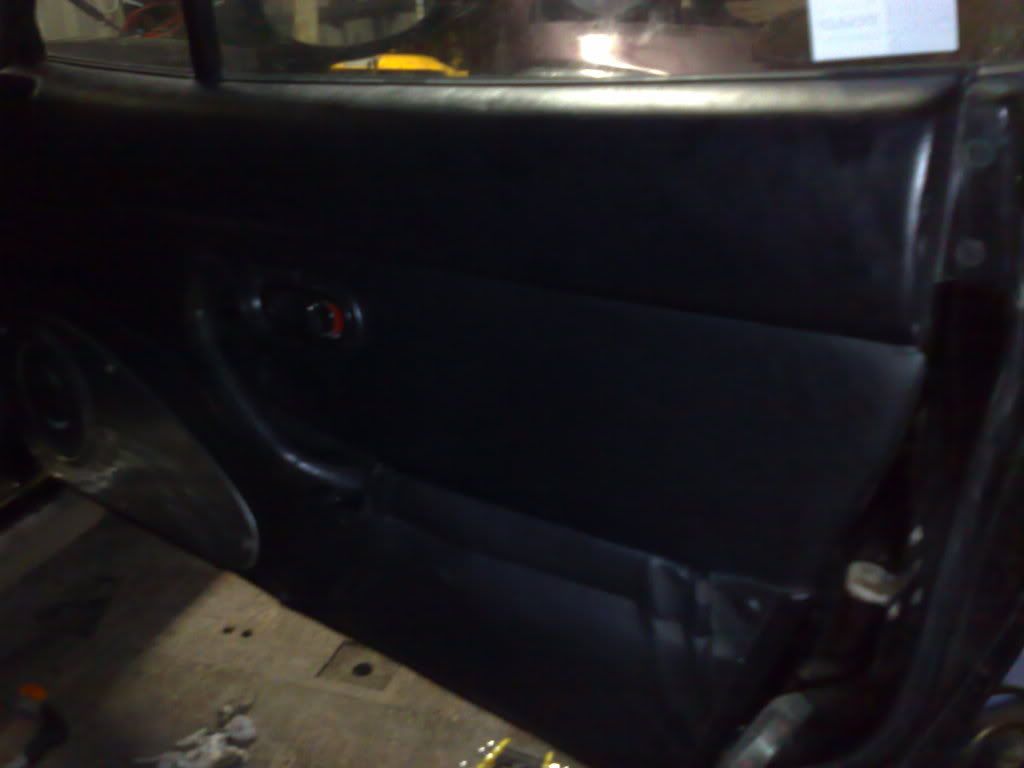

With the hint of Spring in the air today (lovely day here :D ), I said i'd sort that slooooooooooooooooooooooooow drivers door lekky window - took the door panel off -

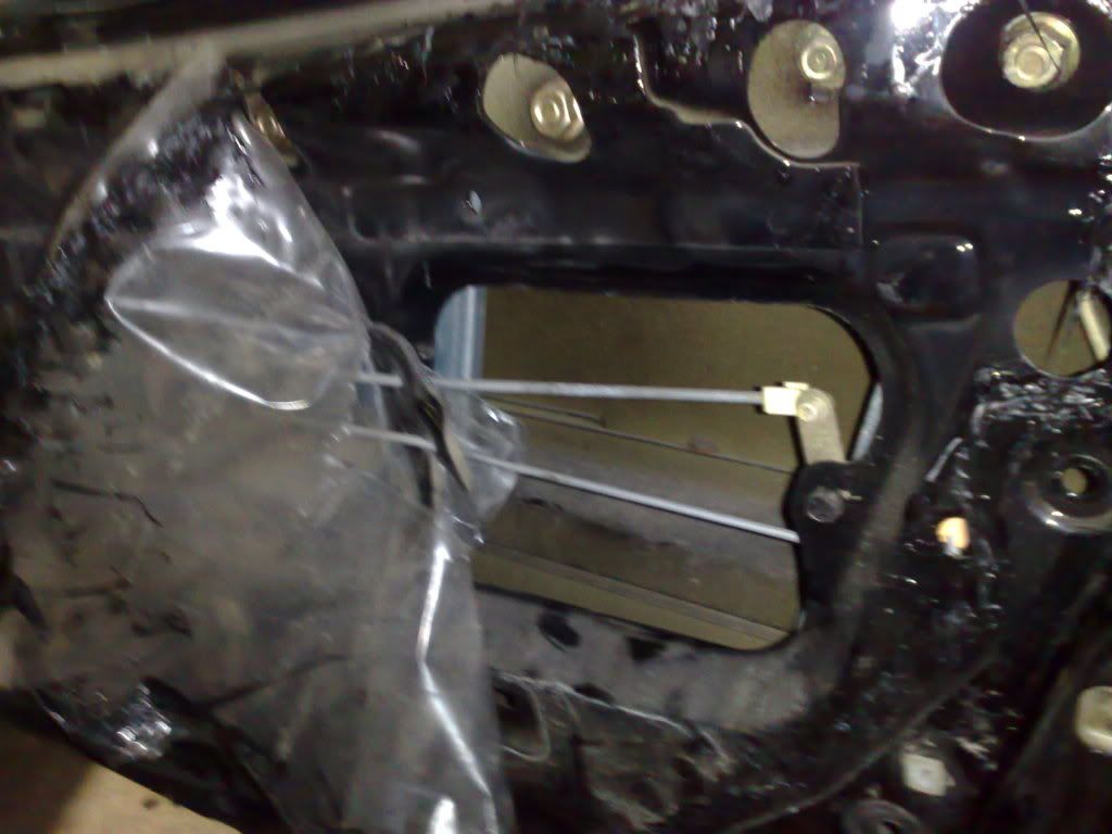

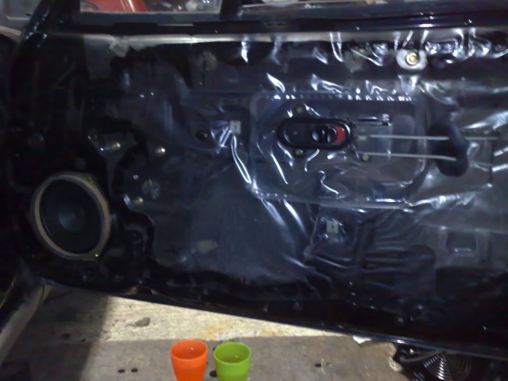

eased away the plastic to get access to the runners -
Then cleaned and re-greased the runners, the windows going up nice,fast and smooth now :P
All back on bar 1 scew and cap :cyclops:
Anyways, worth doing and only a 10 min job if you have sloooooooow windows.
