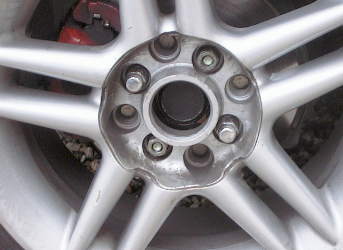

2. - If your wheel has a hole in the centre, result. This is going to be an easy job. Loosely refit the wheel, lower the car and using a 29mm or 1 1/8" socket loosen the hub nut, and smile to yourself as you skip step 3.

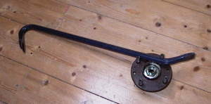

3. - So your wheel hasn't got a hole in it and none of your friends will lend you theirs. Dont panic all is not lost. Start by getting a friend (if you have one) to stand on the brakes while you try to loosen the nut. If there's no one available or this doesn't work place a crowbar between the wheel studs to lock the hub in place. Don't worry about damaging the studs as the entire hub is being replaced anyway.

6. - If not, measure the distance between the 2 threaded holes in the hub and drill two corresponding holes in a flat piece of fairly heavy steel using a 9mm drill bit. Place the centre of the steel over the shaft and place two M8x50 bolts with flat washers through the holes you've drilled and screw them into the hub. Gradually tighten alternating sides, and the hub should slide off the shaft. I say should because I have a pullers and didn't need to do this.
